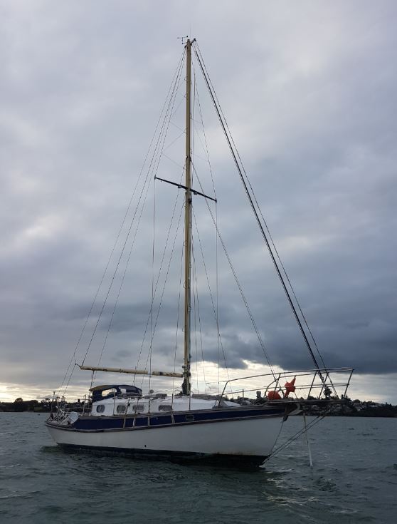

I'm the proud new owner of GH 202 in Auckland NZ. She's in a very run down state having been left on a mooring for about 10years, but about to get a major refit and continue her cruising life.
A past owner has unfortunately removed the bilge plates, so I'm planning to build some and fit them. Apparently she has done some extensive pacific cruising without them, but I would prefer to have the ballast back on the boat.

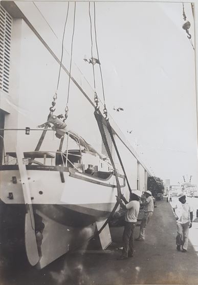

I found a photo of the brand new? GH202 - with keels still attached, presumably just having been lifted off the ship in Florida.
They appear to have been removed in the Pacific Islands, and she apparently arrived in NZ without them.

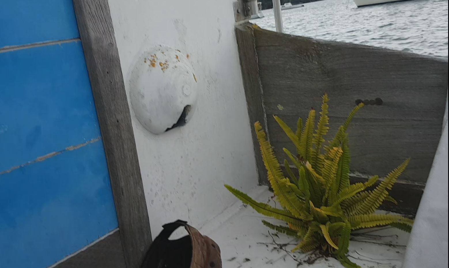

When I discovered GH202 on her mooring, there was a fern garden starting up in the cockpit !
And also a mussel farm below. Fortunately the rot is confined to the cockpit area.
